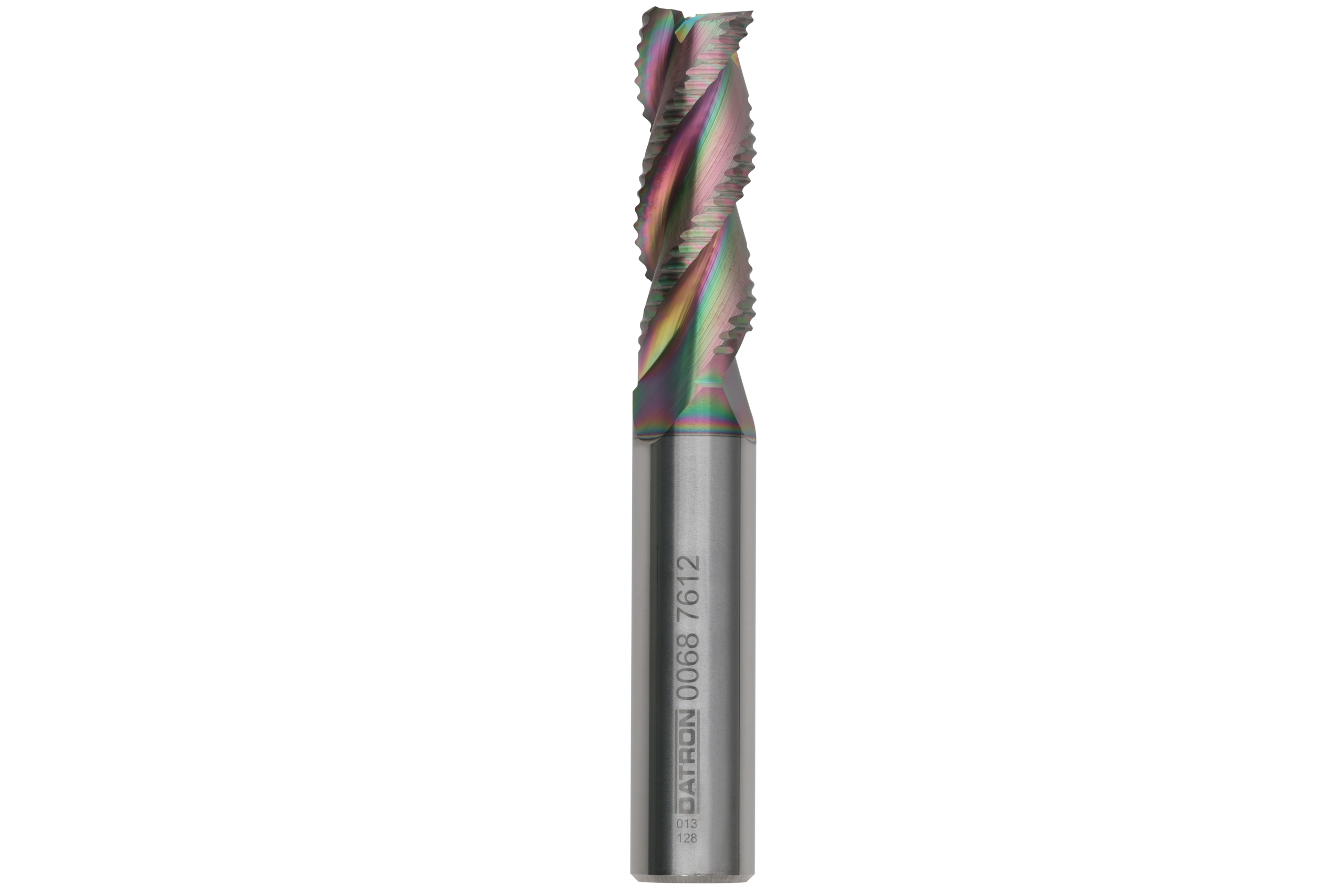

DATRON Roughing End Mill Pros are built for high-performance roughing in aluminum, brass, copper, and bronze. Their optimized triple-flute roughing geometry delivers aggressive material removal, reduced vibration, and stable cutting performance in the most demanding applications.
Advanced flute geometry improves chip evacuation and helps prevent excess buildup during large roughing operations, while reduced spindle load supports consistent machining and greater efficiency. A durable DLC coating extends tool life and minimizes heat generation, making Roughing End Mill Pros the best choice for fast, efficient non-ferrous machining in spindle 3kW and larger.
| Cutting Diameter (D1) | 6 mm / 8 mm / 10 mm |
| Shank (D2) | 6 mm / 8 mm / 10 mm |
| D3 | 5.5 mm / 7.4 mm / 9.2 mm |
| Length (L1) | 57 mm / 60 mm / 70 mm |
| Cutting Depth (L2) | 16 mm / 21 mm / 26 mm |
| L3 | 21 mm / 26 mm / 31 mm |
| Flutes | 3 |
| Operations | Roughing |
