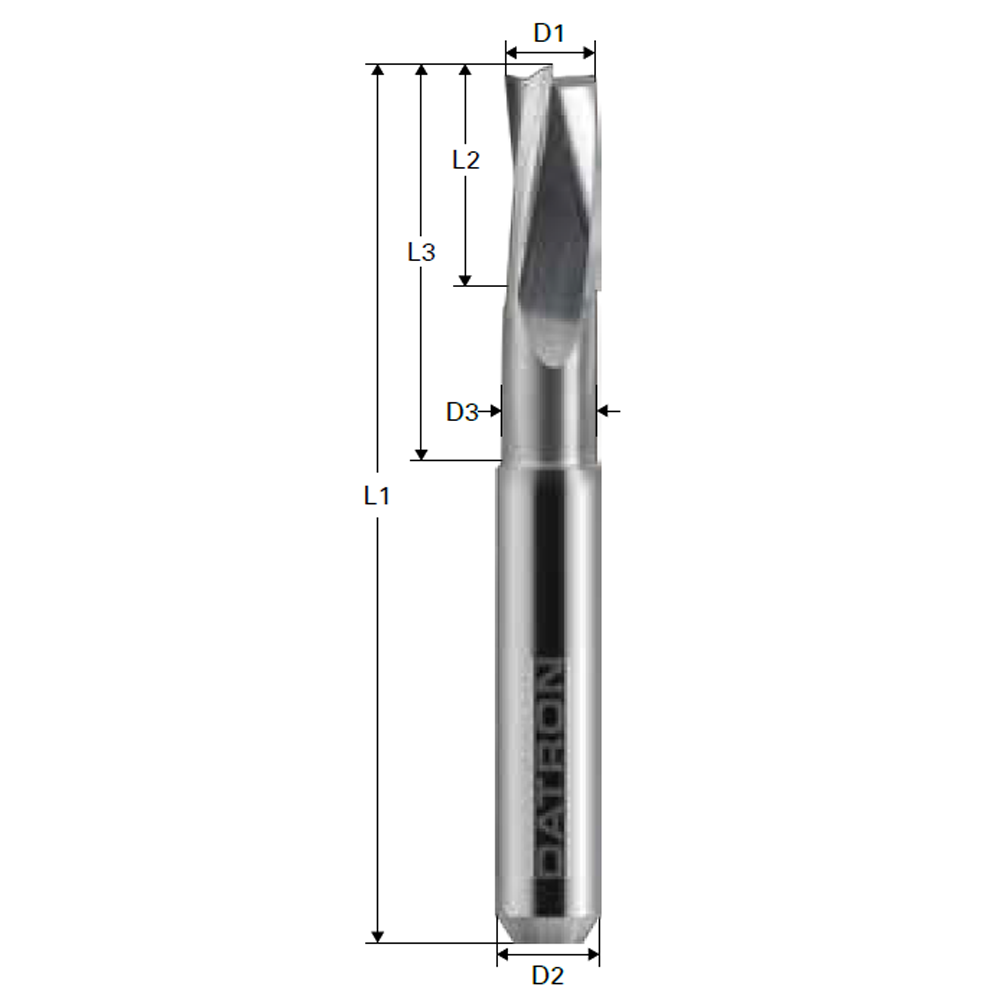

It can be difficult to machine or pocket soft, foam type materials. The soft material tends move or fold away from the cutting forces, often leaving a poor edge quality. Datron has developed a line of tools specifically for machining foam. The combination of cutting geometry with extremely sharp edges achieves high quality edges that present very well for your packaging materials.
Our triple fluted tools are better suited to material-specific applications where lower RPM and increased core strength may be needed. These long-life, micro-grain carbide tools are available in various cutting diameters and lengths, shank diameters, and geometries for specialty material applications.

Article # | The number of cutting flutes in the tool determine how much material can be removed per rotation. For high speed, bulk material removal, single and double flute are recommended. Higher flutes will produce finer finishes, but may require a lower RPM than single flute mills. Flutes | D1 Nominal cutting diameter of the tool Cutting Diameter | D1 Nominal cutting diameter of the tool Clamping Diameter | D2 Shank diameter where the tool is in contact with the holder. D2 diameter can be too large for some machine spindles and smaller diameters may need an adapter to be used with spindles. Shank | D2 Shank diameter where the tool is in contact with the holder. D2 diameter can be too large for some machine spindles and smaller diameters may need an adapter to be used with spindles. (D2) | D3= Toric cut diameter is the relief made above the cutting flutes on the neck to allow a tool to have longer reach when milling deeper features. Also known as extended reach. (D3) | D3= Toric cut diameter is the relief made above the cutting flutes on the neck to allow a tool to have longer reach when milling deeper features. Also known as extended reach. Interface | L1 L1 is the total length of the tool from tip to base. Length | L1 L1 is the total length of the tool from tip to base. (L1) | L2 L2 is the length of the usable cutting edge of the tool. This is only the flutes. Also known as flute length. This determines the amount (depth) of material that can be removed per pass. Cutting Depth | L2 L2 is the length of the usable cutting edge of the tool. This is only the flutes. Also known as flute length. This determines the amount (depth) of material that can be removed per pass. (L2) | L3 L3= This is the overall reach a tool can be used. Flute plus any relief made by reducing the diameter in D3. AKA known as reach Reach | Radius of the cutting tip/nose. Edge Radius | Angle A= angle of a cutting edge. Drills, engraving tools and countersink tools aka point angle. A | Price | Availability | Size | Quantity | Add to cart | Waitlist | ||||
