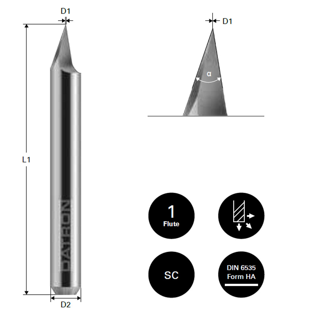

The standard engraving tool is ground specifically for a wide range of materials. These materials include: plastics, aluminum, bronze, brass, copper, wood and acrylic. The carbide cutters can be re-sharpened using a proper cutter grinder. This service is not offer by Datron.
For precision, high-quality engraving, using engraving tools are recommended. The ‘V’ shape design allows you to machine very finite detail while still maintaining a good degree of strength in the tool. The cutting edges have a draft angle depending on the cutter which in most cases is desired for the end product. These solid micro-grain carbide tools are available in various cutting angles, tip sizes, tool lengths and shank diameters.

Article # | The number of cutting flutes in the tool determine how much material can be removed per rotation. For high speed, bulk material removal, single and double flute are recommended. Higher flutes will produce finer finishes, but may require a lower RPM than single flute mills. Flutes | D1 Nominal cutting diameter of the tool Cutting Diameter | D2 Shank diameter where the tool is in contact with the holder. D2 diameter can be too large for some machine spindles and smaller diameters may need an adapter to be used with spindles. Shank | D3= Toric cut diameter is the relief made above the cutting flutes on the neck to allow a tool to have longer reach when milling deeper features. Also known as extended reach. (D3) | L1 L1 is the total length of the tool from tip to base. Length | L2 L2 is the length of the usable cutting edge of the tool. This is only the flutes. Also known as flute length. This determines the amount (depth) of material that can be removed per pass. Cutting Depth | L3 L3= This is the overall reach a tool can be used. Flute plus any relief made by reducing the diameter in D3. AKA known as reach Reach | Radius of the cutting tip/nose. Edge Radius | Angle A= angle of a cutting edge. Drills, engraving tools and countersink tools aka point angle. A | Price | Availability | Size | Quantity | Add to cart | Waitlist | ||||
