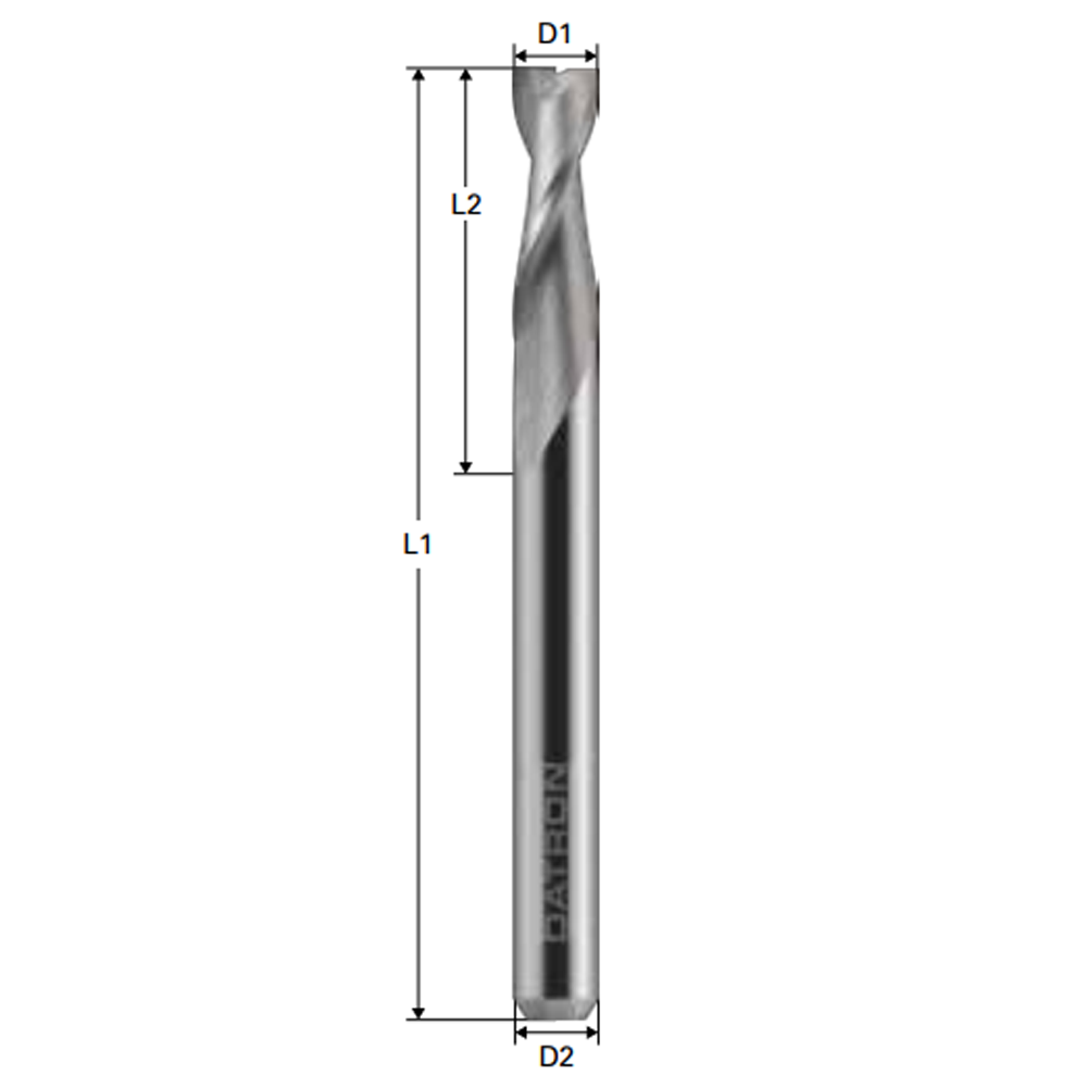

For general, multi-purpose machining, the double fluted tool is a good versatile tool. It is ideal in machining harder materials and alloys. The tool is balanced and strong, producing minimal vibrations which translates into good surface finishes. These tools are perfect for aluminum, brass, plastics, exotic composites and hard metals.
Our double flute tools are ideal for machining when surface finishes are important. They are typically used for finishing pockets and making lighter cuts. Also, they can be used in applications with tiny diameters because the double flute is stronger compared to a single fluted tool. These long-life, micro-grain carbide tools are available in various cutting diameters and lengths, shank diameters, and geometries for specialty applications.
$18.31 – $157.32Price range: $18.31 through $157.32
Article # | The number of cutting flutes in the tool determine how much material can be removed per rotation. For high speed, bulk material removal, single and double flute are recommended. Higher flutes will produce finer finishes, but may require a lower RPM than single flute mills. Flutes | D1 Nominal cutting diameter of the tool Cutting Diameter | D1 Nominal cutting diameter of the tool Clamping Diameter | D2 Shank diameter where the tool is in contact with the holder. D2 diameter can be too large for some machine spindles and smaller diameters may need an adapter to be used with spindles. Shank | D2 Shank diameter where the tool is in contact with the holder. D2 diameter can be too large for some machine spindles and smaller diameters may need an adapter to be used with spindles. (D2) | D3= Toric cut diameter is the relief made above the cutting flutes on the neck to allow a tool to have longer reach when milling deeper features. Also known as extended reach. (D3) | D3= Toric cut diameter is the relief made above the cutting flutes on the neck to allow a tool to have longer reach when milling deeper features. Also known as extended reach. Interface | L1 L1 is the total length of the tool from tip to base. Length | L1 L1 is the total length of the tool from tip to base. (L1) | L2 L2 is the length of the usable cutting edge of the tool. This is only the flutes. Also known as flute length. This determines the amount (depth) of material that can be removed per pass. Cutting Depth | L2 L2 is the length of the usable cutting edge of the tool. This is only the flutes. Also known as flute length. This determines the amount (depth) of material that can be removed per pass. (L2) | L3 L3= This is the overall reach a tool can be used. Flute plus any relief made by reducing the diameter in D3. AKA known as reach Reach | Radius of the cutting tip/nose. Edge Radius | Angle A= angle of a cutting edge. Drills, engraving tools and countersink tools aka point angle. A | Price | Availability | Size | Quantity | Add to cart | Waitlist | ||||
